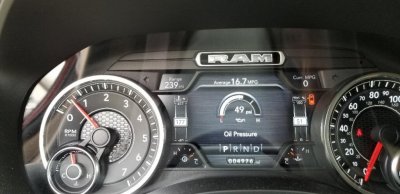

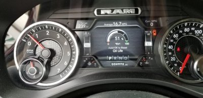

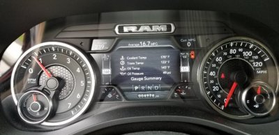

View attachment 163383 View attachment 163384 View attachment 163386
Your right Arth. They both match now or it was my eyes.
Yeah just like I thought. First picture is of your oil life remaining. You've got 51% life left.
Second picture is of the oil pressure like you know now.
Third is the guage summary giving you the three temps and oil pressure you can see.
Considering you are just shy of 5000 miles your oil life meter is set to 10,000 mile intervals.
Also you've got the screen setup to show oil life percent as one of those side bars.
