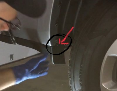

Question for those that installed theirs. Did you have the rear bottom screw hole left without a screw in it?

If you post a pic of the missing screw I can look at mine. Some dealers don’t know how to install them correctly. The rear factory liner gets removed and it is actually two liners over each other, you separate them and reattached the one that has the nut clips on it. Then you install the full liner over it, some dealer don’t put the rear factory liner back on.

Here’s a shot from the video install on YouTube. The mechanic said they didn’t have any left over screws and what I’m seeing is they didn’t order the extra screws for it. Mainly posting this for those that will/might have the dealership or any mechanic install them to know they have to order 2 extra screws for the “correct: installation.

Thanks for the reply also Mike. I’ll need to check mine to see if they installed the rear liner also.

The full liner doesn’t have the nut clips on the rear lower half because there are clips on panel that gets reinstalled.

Just a follow up here. When I went and talked to the installer he didn’t know he had to separate the rear splash shield and use part of it for the full liner install. Showed him the YouTube video and he watched it that night. Went back the next day and he installed my liners correctly with all screws installed. Seems these things don’t come with instructions nor is there any tech bulletins for the dealers to follow.
