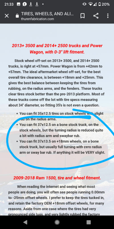

I'm pretty sure if you get the right wheel and tire combination (wheel offset) you can stuff 37s on stock suspension or with only a two inch front level.
Maligator
Jun 30, 2017
1,162
1,643
Hem 5.7
You can fit 37s with no lift whatsoever. Stock wheels will work but you may get some rub on the radius arm at full lock and at/near the pinch weld. An offset of +18mm to +27mm is the sweet spot for power wagons. I have +18 mm offset wheels with 37" coopers and thuren level springs and had to trim just a bit of plastic near the pinch weld. Nothing short of a 4" lift is gonna help you with tire size. Guys are running 40s with just a level, offroad bumpers and AEV flares on 4th gen rigs

Search the forum and you will find a few 19s that have already put 37” tires on stock rims. @Breaker Alex did it a few months ago and stated just a little rub on full lock on the drivers side as @Maligator just stated. No lift was needed. There are a few Build Threads on 2017 and 18s that have lifted the front to level to make 37s work.

Thanks for the input guys! So I gather Thuren is the way to go then?
crazy jerry
Apr 5, 2016
1,311
925
WY
ya it seems most everyone uses thuren for pw stuff

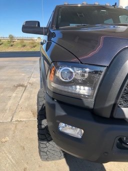

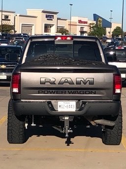

Disclaimer: Not 37s. For what it's worth, I went Carli Commuter with Carli tuned Fox 2.0 shocks, and am extremely happy with it. I decided I wanted to keep (and improve) payload capacity, hence the move to Carli (Thuren rear coils are far too soft, and they state as much). This was the only ding I had on Thuren, otherwise I would have gone that route (I did add a Thuren King shock steering dampener though).
My setup is a 2018 PW level with Nitto Ridge Grapplers 35s on 17x9 + 0 Method Grids.
Mailgator is absolutely correct. 37s on factory is done all the time. My only concerns with that approach is my truck is a daily driver and I still want to have fun with it. I find with my lift, and tire/wheel combo, I can go just about anywhere and never worry about rubbing. Passing a gas station without first looking at my gas gauge approaching empty is my only risk. :cool:
Best truck I have ever owned. It goes where I want, tows want I want and stops at every gas station I need.

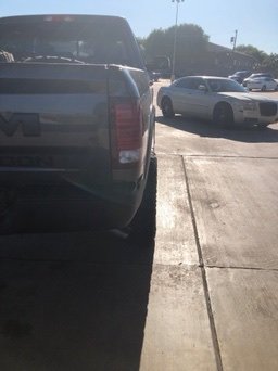

Do you have a down the side view of your truck? 0 offset doesn't look to poke out much with the pic you posted.
Sure. Here are a few more.

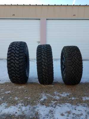

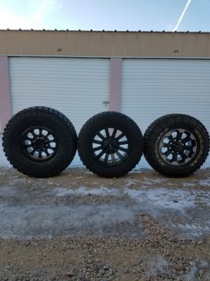

this is what i think from my experience. 35x12.5 0 offset rubbed on the driver side rear plastic when turned left backing up. cab seemed centered on the frame best i could tell. although the driver side axle was about 1/4" closer to the fender rear corner. frame geometry tolerance wasnt perfect maybe. who knows. but what i do know is turning the caster cams slides the axle forward and backward. keeping on the high side of the range gives a bit more tire clearance at the fender rear corners and besides that it just simply drives better imo.
35s used to be my tire of choice but ive put them in tempory retirement while i try some 37s. sure ill have to hack into plastic and possibly sheetmetal, hopefully not.
after trying 4 different wheel and tire combos in the last two years ive learned a few things. with these recent 37s i took a different approach. measured wheel runout before tires were ever mounted. put a mark where the machine indicated and lined up the red dot to the mark. had to run a few errands while the first two tires were being mounted but i made it back to the shop just as they were getting started on the other two tires. one ended up at 15lb road force and the other at 13. tire guy said the first two tires had very similar numbers. weight needed was 6oz, 4oz, 4oz, 2oz. not bad not bad. should run smooth like grampas old caddy
L-R 37x13.5 new, 35x12.5 17/32 tread, stock setup new

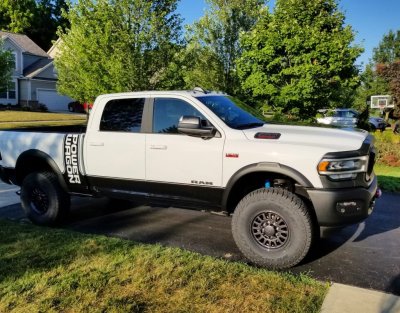

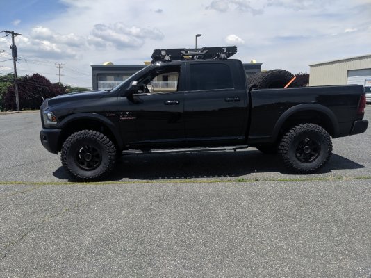

This is also 37’s on stock suspension. With the wheel offset, he had to trim a bit of the plastic flare off...
