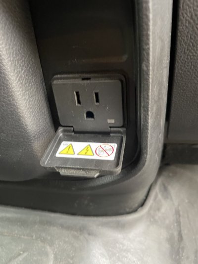

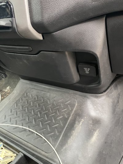

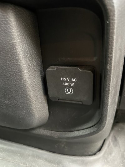

I recently bought a used 2019 Tradesman 4X4 off road and the 115V AC 400W outlet doesn’t work.
I read on another post that the outlet was on fuse 38 but mine reads as
F38 DICM / ACT CL TEMP VLV which I didn’t think meant outlet.

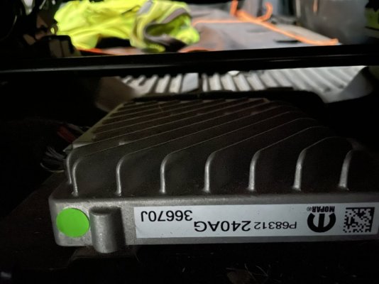

I also read that there’s an inverter under the passenger seat but only found an inverter looking thing under the drivers seat.
See pics of outlet, fuses, fuse cover and the underside drivers seat inverter.
Any hero wild be greatly appreciated

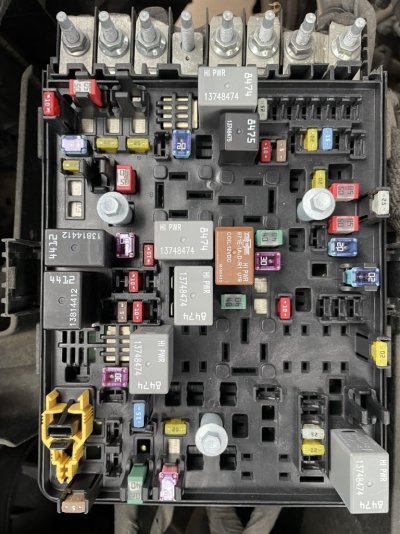

The picture I posted was the fuse box under the hood. The link in dredgers reply is for the internal fuse box tgst I haven’t even looked at.
I’ll open up the under dash panel and check there for a busted fuse and see what I can find.
Thank you both for your help.

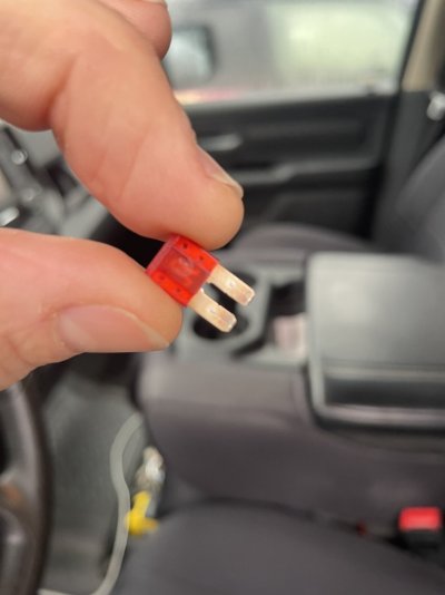

I’ll also look at that 10 amp red fuse circled but that seems like it’s too small to run that outlet.
Stay tuned for an update.

Sorry, got my pictures and diagrams mixed up. :sad72:

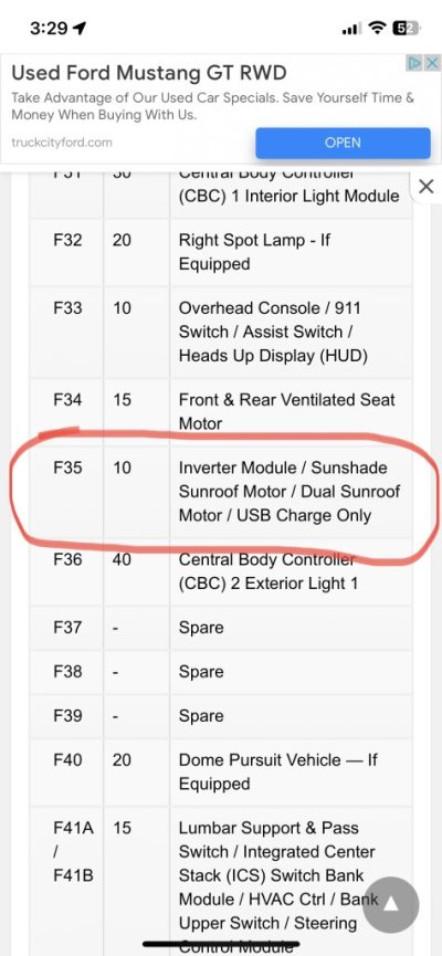

This is from the internal fuse diagram F35 look like the right fuse for that outlet?

I had the same problem, I took it out and unplugged it then reinstalled and it worked. I never replaced the fuse. Hope it helps.

Pulled that F35 from the internal fuse box and it looks good to me.
Is that the right one? Only one I saw with inverter on it.
Good point about not having one even though there’s a plug for it… is it bolted to the floor board under the passenger seat or in the underside of the passenger seat?
Any tips on getting it out?
Screw driver in the slot at the top

There is a 50 amp fuse in the fuse box in the engine bay. F4 should be the location of that fuse. That is the one I replaced and my outlet is still not working. I will try the one under the dash panel and see if that helps.
You have a fuse box in your cab? I don't. My only fuse box is in the engine bay next to the battery.
