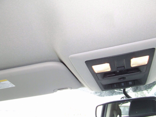

I don't know if many of you have read the owners manual
( Mine is still wrapped up in the factory package )
I read the manual online,
There is a paragraph or two that refers to the Microphone that is located in the interior mirror
Basically it reads to turn your HVAC Fan down to Low or OFF
Turn the radio down & roll up your windows, when you want to use the microphone .
Basically they are admitting that the microphone is in the worst possible position
Others have studied the vehicles interior & found that the best place to locate it, would be on the drivers side "A" Pillar, at about head height & almost touching the windshield.
In that position, there is no cross breeze & is less likely to pick up the fan noise.
Another position would be up close to the map lights, in a line with your nose.
Drop the overhead console, you can just let it hang
drill a hole in the head liner, just large enough to fit the microphone
You don't need to drill through cloth like material, just scrape a bit of the insulation off inside of that material to allow your voice to pass through it, hang the overhead console back into place.
I know sound will easily carry through that material
i have an auxiliary speaker for my CB radio mounted at the back of the overhead console, you would never realize it was there, unless you were looking for it.
Look at the roof liner, directly in the back center of the overhead console, there is a darker area that is somewhat circular
