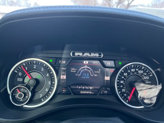

2022 Ram with the E-Torque and mine has stalled out twice now this winter. Same thing as others when coming to a stop sign and accelerating engine stalls. Upon restarting the battery light stays on and the charging voltage drops in half of the normal 14 volts. Shut off the truck again and restarted and all lights cleared. Dealership said to replace the battery which I will this weekend and see if that solves it. It also only seems to happen when it's cold and the engine isn't fully up to temp. I already filed the the NHTSA so we will see where that goes.
