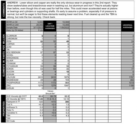

Just thought I would start a thread to track the issue I ran into with my 2022 HO 3500. I have noticed it has been doing frequent regens lately and it finally threw a code (P2459). No change in power or drivability. I took the truck into the dealer and the fix that is suggested was a PCM update and replace the rocker arms. Unfortunately, the checkout guy did not have a great understanding of the reason for this and the mechanics were gone so I don't have any additional information on if it is just the rockers or the rocker and lifters or something else. He said the mechanic said the valves were not completely opening. I would be really interested in what test was done to find that out but I haven't run across much information on the internets as to needing new rockers. I have seen some information on the issues with the hydraulic lifters but even that is limited. Parts are on order and should be heading back into the dealership next week. Hopefully to get more info as well.
Here is the background on the truck:
21,000 miles
Ordered from factory and delivered in May of 2022
First 8 months daily commute 120 miles round trip all interstate
Current daily commute around 60 miles of mixed city and interstate
Pulling a 5k-17K trailer on weekends
Oil Changes:
5K - Schaffers OTR 5W-40
15K - Schaffers OTR 5W-40
20K - Shell Rotella T6 5W-40
Oil analysis showing high aluminum and iron:
View attachment 518605View attachment 518606

Something is strange here. The code was set because the ECU is detecting frequent DPF regenerations. This typically happens because the vehicle is lacking longer cruises to effectively run a regeneration cycle. Based on your reported typical drive cycles, this isn't the issue.
What else can cause this issue? I'm not seeing a connection between rocker arms and the high frequency of regens.
Have you made a recent modification under the hood?
Do you buy your fuel from the same location?
I can make some guesses;
Faulty sensors, MAF, pressure, NOX, inlet/outlet temperature sensor.
Faulty injector.
Bad fuel (try some Hot Shots Every Day Diesel), Hot Shots has an excellent and informative explanation as does Power Service on their websites that explain fuel/emission issues.

For the regen to occur, the exhaust has to develop a lot of heat. To do that, the injectors are fired an additional time so that raw fuel blows out into the exhaust. If the exhaust vales don't open enough, not enough of that fuel goes out. It explains the high aluminum content as the fuel remains in the cylinder and washes the oil off the cylinders and causes higher wear on the pistons.
This is all theory...YMMV

The truck is generating too much soot from the valves not opening properly and letting in enough air for the fuel (too rich).
The DPF can only process a certain amount of soot after that it needs to regen. Too much soot is what causes too frequent regen which causes a code to be set even if driven mostly on the highway. The rich air : fuel mix could be due to the rocker arm wearing a hole where the push rods touch it and as a result the rocker arms not pushing on the valve sufficiently to open it as long or wide as it should. That is why your Iron is too high in the oil (rocker arm wear out). Your AL is high because the Iron shavings are circulating in the engine before it reaches the filter and causing abrasive wear of the softer AL components. The PCM update could be to modulate the EGR to be less aggressive and add less EGR into the oil.

Makes as much sense as any theory I have. The next question I will have is what would cause the rockers to wear so quickly in 20K miles? Is there an update to the rockers that would prevent the wear or is there another defective component that lead to this (plugged oil passage)?
