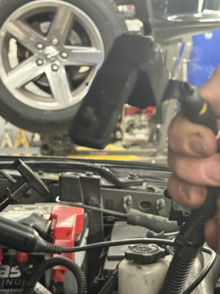

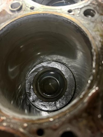

Hello all.
I bought my 2022 RAM 3500 Limited with a 6.7 Cummins HO brand new that same year. It currently has 75k miles on it. Unfortunately, I'm one of the lucky ones whose grid heater bolt came loose and got sucked into the intake. It made it through the intake valve of cylinder #5, cracked the #5 piston, and shot out the exhaust valve, manifold, and it looks like the turbo. See pics below.
It's been at the dealer for almost 2 weeks awaiting warranty approval from Stellantis. The latest update is, "Keep waiting."
Anyone have a similar experience? If so, how long did it take to get this resolved. Without warranty coverage, this could have been a $20-30k expense. Thank God for the 5 year/100k powertrain warranty!

Wow, that stinks. Wondering in this case, will they just replace the damaged piston or?

View attachment 579611 View attachment 579613View attachment 579612
OMG was that engine feed a steady diet of B-20 along with a bunch of city driving?

Did you do the wiggle test during your ownership, or just fly blind? That bolt doesn't fail instantly. Do the BD grid upgrade, and skip the overpriced Banks nonsense. That elbow does 0.00 for a stock truck. The grid heater was trouble free from 1989-2006, until Cummins cheapened it up with the rollout of the 6.7.
Honestly, I didn’t know it was an issue until after the fact. That’s when I learned it’s an actual thing. Should have been more involved. I did all the proper maintenance with my local mechanic. Sucks!

I thought there was a recall that solved the grid heater problem. seems like I took mine in for something related to that.
There was a separate problem with the grid relay when they went away from the reiable electro-mechanical solenoid to a solid state relay. Certainly a stuck relay could cause the bolt to fail, but that is not the whole issue.
They skirted a recall/proper fix by going to glow plugs, which I do not favor, and just leaving owners holding the bag.
