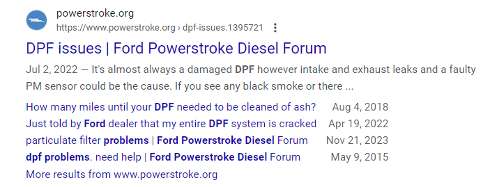

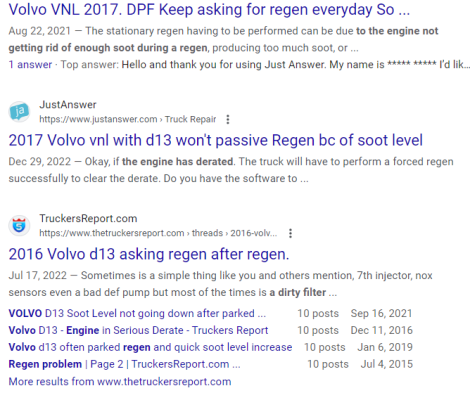

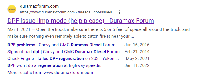

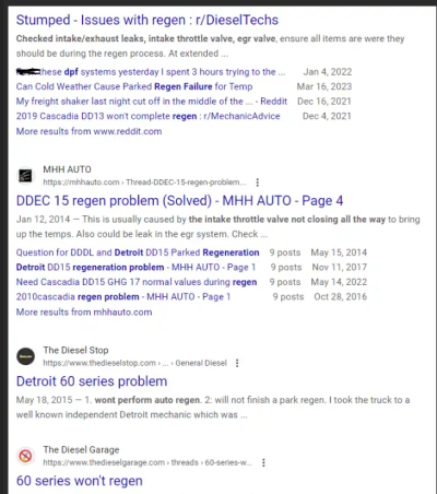

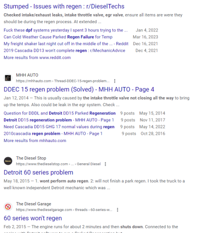

It's more than just Cummins.... you fail to remember that the same equipment is on EVERY modern diesel engine and all of them suffer from similar problems. It doesn't matter what you own, you're going to run into this eventually.
You can thank the EPA. There's only one way to solve the problems and it's not a way that they like.
Powerstrokes:
Duramax:
Heavy Equipment:
