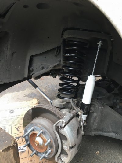

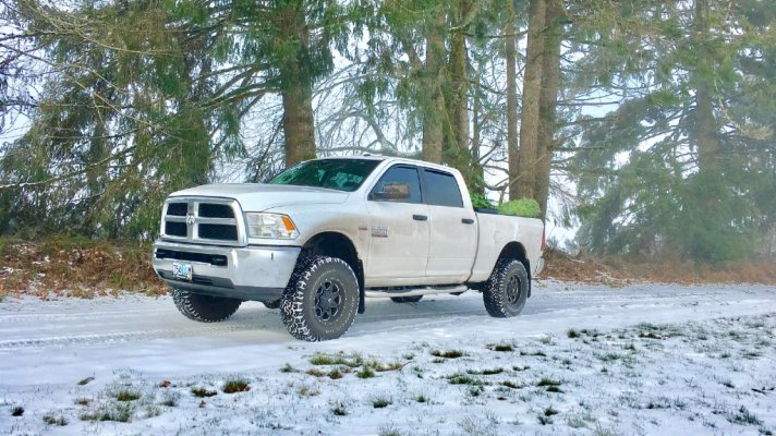

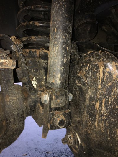

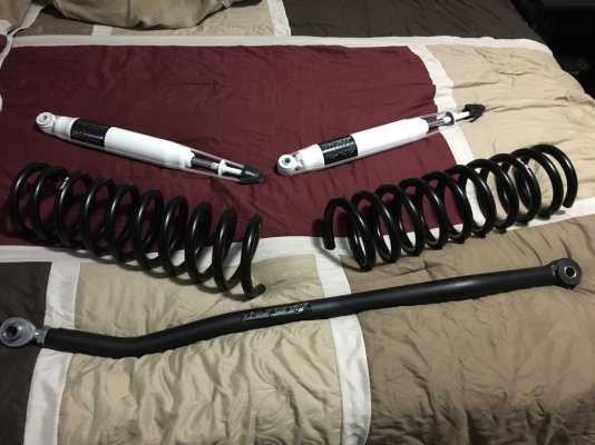

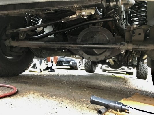

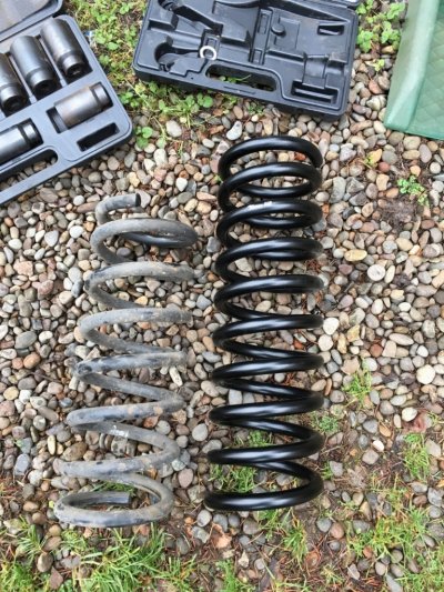

I put in a 2 1/2" RCX Spacer and shock extensions 6 days after I purchased my truck. 4c717d1dcb6d9e49edc645485711f6bb.jpg6c0bbe22fb8bc682670b108ea5a2ad66.jpgRide was not really effected, but also went from stock 275/70R18s to 35x12.5R17s the next day.26274bb2758eb4684678f6c2a4ff3547.jpg5 months later I purchased my 2" Thuren Overland front level kit. Including 2" soft coils, adjustable track bar and front Overland shocks.fa1b2008c6659cbd2b34bebe6e3eec64.jpg85061003bf9338141bfcb861b003dbf3.jpg3f8b341b47d2fb6eed98070210b39721.jpg0e0c07a196a431b149326e9385156507.jpg4171b48330768b4dfda50d8a4ae43b0d.jpg8f6867b0223afcefd6c9ca2240bce784.jpgThe Thuren kit is a huge improvement over the RCX kit, ride was greatly improved.

Thank you! She's coming along very nicely! Yeah, my HD with a 2" on 35s sits as tall as a 1500 with a 6" on 35s! Yeah, spacers aren't the best option, I used them temporary since I didn't wanna go more than a week without 35s lol, then saved for the Thuren kit. I purchased the front end kit from Thuren's website.
https://www.thurenfabrication.com/p...stems/2014-2500-2013-3500-overland-front.html
You can buy just the coils, or the kit, I got the kit witch was $780 before shipping.

Did the 2inch spring sit higher or lower than the 2.5spacer. the pictures of both are difficult to tell.
