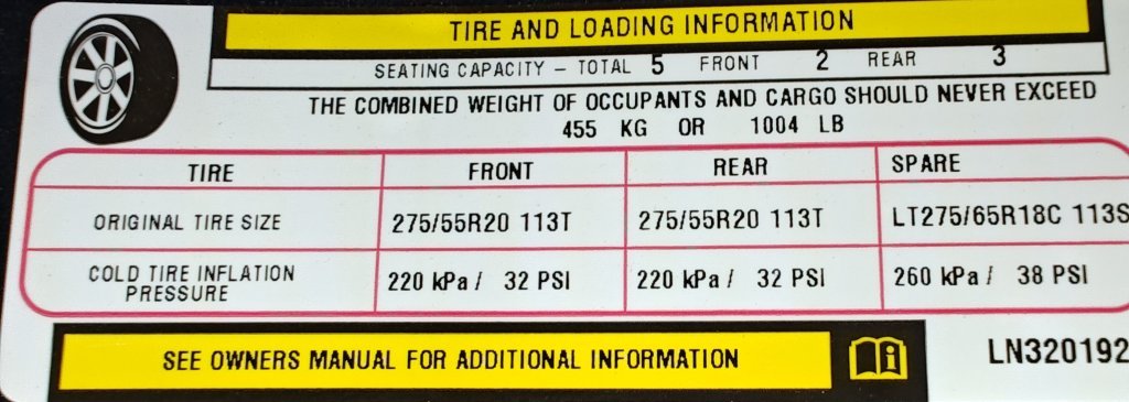

Nice label. I have a 2020 limited. My Gross Ratings label is shown below. My GVWR is 300 lbs more than your truck.
The second label shows the payload. The label is directly adjacent to the Gross Ratings label on my truck. The payload of interest is "THE COMBINED WEIGHT OF OCCUPANTS AND CARGO SHOULD NEVER EXCEED 455 KG OR 1004 LB".
Please note that "CARGO" includes 5th wheel receivers and pin weights.
I'd call that rather definitive. If I put 5 people and a sack lunch in my truck I'm at load limit. Please do NOT attempt to explain why you think you can LEGALLY add a 1500lb 5th wheel to yours.
I'm in agreement with you, but as a non-commercial operator there is no "legally" anything involved here as there is no law that says you can't overload it. Although that issue may come up if you get in an accident. It's just a horrible idea to do it.

Not really. The sticker clearly shows that your stock tires are your limiting factor.
Actually, the limiting factor is cargo capacity. You cannot increase it by any means whatsoever. Not with different tires, not with air bags, not with a WDH, not with anything. It is the absolute maximum you can safely carry in or on your truck.

I'm rather happy with the Falken Wildpeak A/T's. They've worn well and ride decently. I'll probably get the same tires when the time comes. At 2535lbs Max load per tire they are already well above either of my (or your) axle ratings. I don't see the point in jumping to a load range E tire - I don't plan on overloading the truck.

I'm rather happy with the Falken Wildpeak A/T's. They've worn well and ride decently. I'll probably get the same tires when the time comes. At 2680lbs Max load per tire they are already well above either of my (or your) axle ratings. I don't see the point in jumping to a load range E tire - I don't plan on overloading the truck.
If your not running stock tires, then why use that number for "never exceed". If the tires are capable of the load, then the GVWR is your number to not exceed. But then, you have never exceeded a speed limit either, right?
One last time...
Truck is bone stock with Falken Wildpeak A/T3's 113T's as the label specified. Max load is 2535lbs / tire (i corrected my typo above). At 5070 lbs combined, the rear tires are still rated 970 lbs above my rear axle (4100 lbs).
As others have already pointed out, the load rated is determined by the GVWR and curb weight.
GVWR - Curb Weight = Payload
For my truck that's
7300 lb - 6296 lb = 1004 lbs MAX payload.
What are your #'s?
It's not the tires that are the limiting factor - they almost NEVER are the limiting factor when it comes to weight in a 1500, or any half ton truck.
It is ALMOST ALWAYS the springs/frame/axles.
You've got a RAWR of 4100 lbs, and it's NOT your tires that are dictating this. It's the weight of the truck (including all options) versus the axle/springs/frame. I don't know how many ways we can put it out there.
I've been a part of this discussion here and on other forums, and the consensus among those who look at and understand the numbers is that there are VERY FEW half-ton trucks that can pull a VERY FEW number of fifth wheels and not be over payload/axle weight ratings depending on which number is more important to you. Most of those half-ton trucks are unicorns with some kind of max payload package and very few, if any, options. Most of those fifth wheels are less than 28 ft in length and MIGHT have one slide. Pretty much any other combination and you're outside what the truck was designed to do, and you're not running safe.
For other people's sake, I hope you're never in an accident, because there's a good chance you're going to ruin their life. You don't have a truck that can handle the extra weight of a fifth wheel but insist that you can do it. And sure you can, until you can't.
