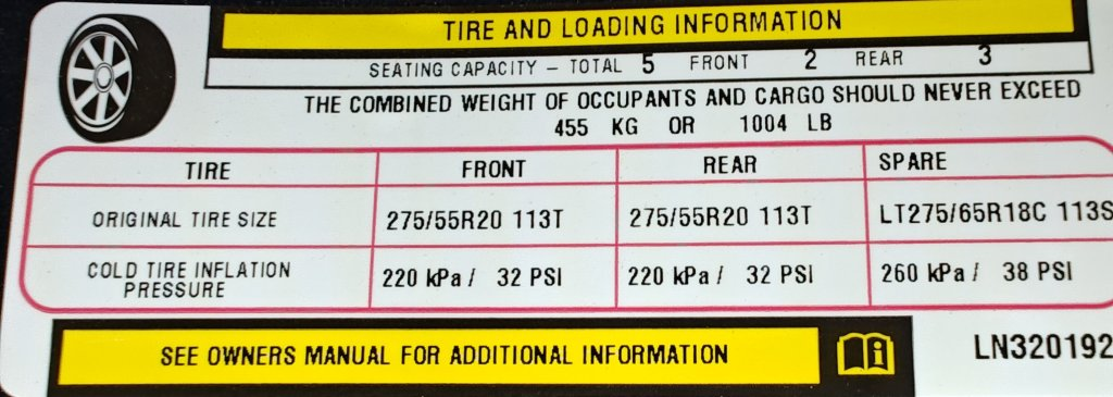

So your payload is 1,004 lbs, meaning you cannot load more than 1,004 lbs onto the truck above what it came with from the factory.
B&W turnover ball underbed hitch is 96 lbs.
Paragaon tonneau is 35 lbs.
Before you even add any passengers your usable payload is already down to 873 lbs.
Let's assume that it's just you and one other person with no extra cargo and that your combined weight is 350 lbs... your usable payload is 523 lbs.
Based on payload numbers the GVWR of your fifth wheel would need to be roughly 2,600 lbs to stay within payload. Not even an Escape 5.0 is that light.
But, assuming you don't care about payload, your RAWR is 4,100. Half of that is the truck. So if you take the cargo numbers above (B&W hitch, tonneau, passengers) you are starting with a usable rear axle weight of 1,619 lbs. That means to avoid exceeding the RAWR you would need a fifth wheel with a GVWR of 8k lbs. The Escape 5.0 would be about the only one that could pull that off.
What kind of 5th wheel do you have? I am convinced that you're trolling the board, because I cannot imagine someone being this ignorant of towing to attempt to put any kind of weight behind that truck.
