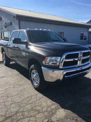

Here's a picture from the day I got it. Kinda bare bones. Has backup camera and sensors, the stock Firestone A/T's the smaller touch screen, the manual 4x4 shifter, and Chrome appearance package, I'm pretty sure the tow mirrors were standard, I'm not sure. All I've been able to do is throw some Lund RunningBoards on it.
