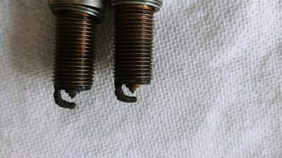

Changed out all spark plugs, still experiencing the same vibration. Still getting a cylinder 1 misfire though, so a new coil is next. If I get a minute I'll post a picture of the plugs that came from cylinder 1, they look awful.

Cylinder 1 on top 3 on bottom for comparison. Last 2 pics are close up of cyl 1 plugs

Looks and kinda smells like oil, but tough to tell. Did a compression test and had 170lbs so seems fine. Next step is swapping injectors, then I'm clueless on my misfire. Vibration still exists and still appears to be in the transmission
