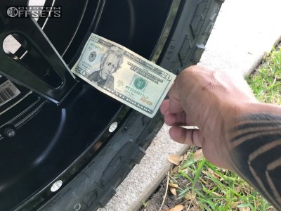

Test fit a wheel lol, looks like its about ½" inside to flush with flare.
Endless tire size options! I may stay a 275/60 falcon or general apt or go to the 275/65 nitto g2.
What lugs should i go with, gorilla? The stocks were too wide.
