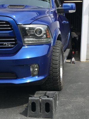

10" -24 offset wheels are flush with the top radius of 4th gen OEM flares.
Here’s my old setup with 13” wide tires, the 275s on now are even again
