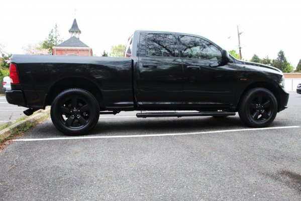

Hey guys. I’m thinking about putting 275/65R20 for my rear tires & 275/60R20 for my fronts.
Has anyone had any experience with this? Good or bad, please share. I did my research(online). I’d like to know from someone with knowledge first hand.

Is your truck a 4x4 or rear wheel drive? If you have a 4x4 you need to keep them the same size. Even if you only have a rear wheel drive, the different size tires will probably throw your ABS/traction control out of whack.

Only if your 2wd,won't work on a 4X4. 295/45/20 and 305/50/20 on mine.
It’s 2WD mainly but has 4x4 option for tow but that’s only at low speed and short distance. I have the Express extended cab model. Just wondering since it’s not in 4x4 mode all the time. Thank you for taking the time to respond. Truly appreciate it
Thanks. I’n in 2WD mainly but have the 4x4 tow option. Was hoping I could get away with it.

If you're truck is a 4X4 i wouldn't do a staggered tire set-up,you're transfer case will hate it. My truck is a 4X4 but it's had all the front end 4X4 parts removed,ie: front driveshaft/ front diff and axles for drag racing,so techinically it's a 2 wheel drive truck with a transfer case,lol
