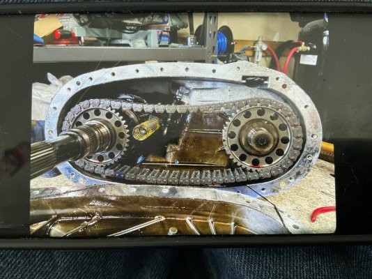

Worn transfer case chain and internals. Chain rubbing on the housing. Drain the fluid and see what kind of shavings are in there.

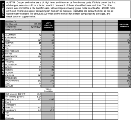

Here's my transfer case oil analysis...didn't think much of the extra metals since they seemed above average, but not too high. But now that I'm having this issue, I'm thinking more and more that @star_deceiver is right. Is there an easy way to crack open the transfer case and poke around or is it a fairly labor intense job?

My coworker is currently doing a rebuild of his NP273 from his 2011 Cummins… on deceleration, the chain rubs the housing.IMG_4112.jpeg

wow...that sucks if that's what prompted the rebuild. I'm curious how common this is...
I wonder if the cause is a loose chain. You could replace it, clean up the housing, put it back together, and get another 100k miles out of it. The other cause would be the shaft/bearing tolerance opening up allowing for axial/radial play. In that case, the full rebuild is needed. If you could get some more info from your coworker, I'd really appreciate it.
