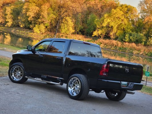

I had 285/60 20 Nitto Ridge Grapplers on my stock 20x8 wheels on a stock 2017 2WD crew cab and had zero rubbing issues.
