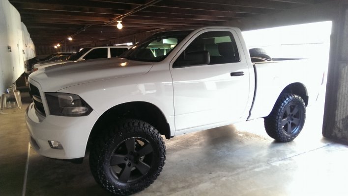

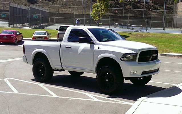

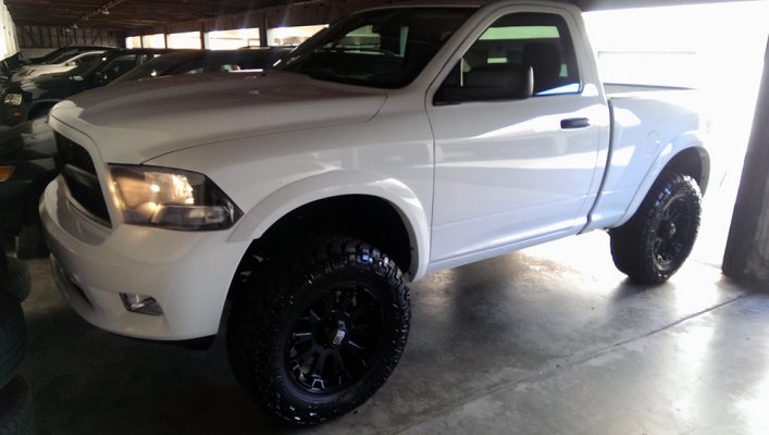

I'm very happy with it over all. I love the look. Remember the front wheels will stick out more after the lift. I think its somwhere around 1.5"? If i were to do it again, I would of gotten wheels with a positive offset. Somewhere in the teens. I actually thought the +18 stockers tucked in there perfectly. Thats my personal preference, though, I prefer that tucked look. There is also a slight rake in the front if you dont get the extra rear spacers, which gives it a subtle cali lean. I like it personally.
How's the ride?
The ride actually didnt take that big of a hit until I got new tires. To me the ride was still good after the lift/before the tires. With the M/Ts its not comfortable, but not horrible. It definitely takes more effort to keep it in a straight line.
What shocks you go with?
Maxtrac
What size tires you running?
295/65/20 Trail Grapplers. Ends up being a little over 35"
Any way you could take pic's?
For some reason none of the pics i take make it look as big as it is. In person it looks much bigger. Im not sure why

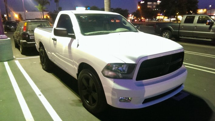

Looked pretty sad before the tires
Before the lift
