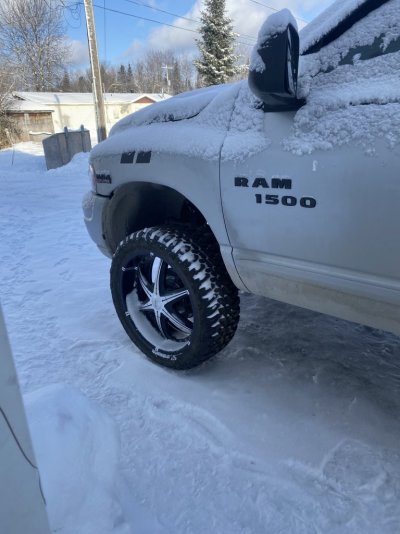

Good day,
Wanted to check on here if anyone has run 35/12.50/24 on a 2005 dodge ram 1500 5.7 with a 3” body Lift and 2” shocks/torsion keys up front without any rubbing?

4.7
absolutely they will fit might need to trim and i mean ever so slightly bump the rear corner of the fender well with a hammer where the spot weld is. by the way have you looked and the RammCamz Maxx Camz torsion keys made by Suspension Max? I put a set on mine two weeks ago, you can dial in the exact amount of lift that you want without any of the "counting how many turns this was and how many that way, just set the insert to the height that you want and put them in.

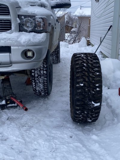

Well started on switching out the tires, however only got one switched and had to leave town. No clearance issues! I have to install the other 3 when I return home.
