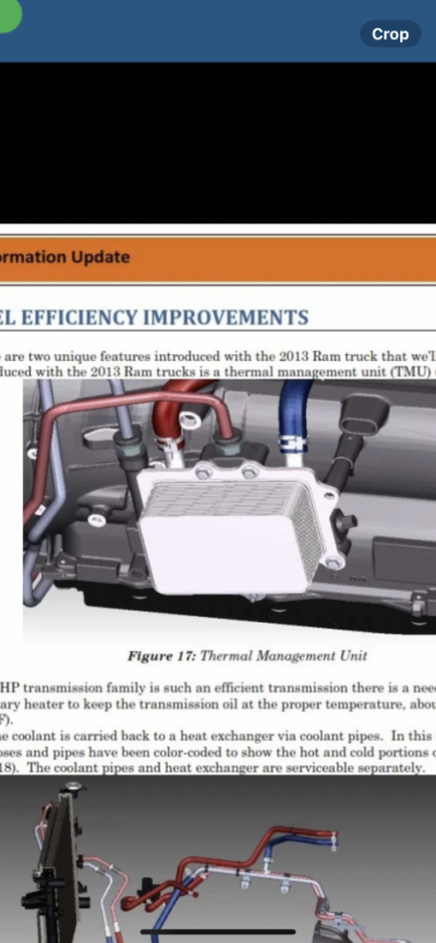

Thank you! So I would T the red and blue lines? Do you think that's where water is getting in the transmission?
