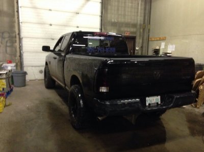

For a budget setup it was great, my truck was primarily a daily driver on pavement and I've got nothing bad to day about it. The 2" rear lift left the rear about 1" higher than the front.

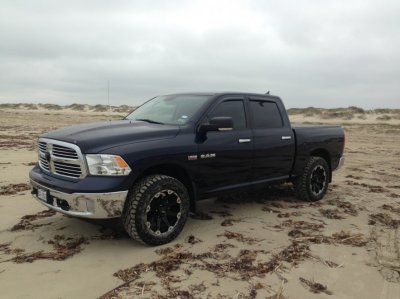

If your only going to run 33's then 2" up front with give you extra clearance without making the tire look small. I had a 2" on mine with a 285/60r20. They are 33.4" x 11.8 I think. I could have got a bigger tire like a 295/60 -34.1 " without any issue. Plus it doesn't affect the angles of the cv much at 2" or 2.1" if your using a Bilstein. I had 3/4" rake left on my 13 with the 2".
