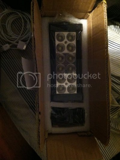

Got it for the girlfriends birthday figuring it would take a few weeks to get here from land of knock off electronics, I was wrong, it was here in 5 days
Pretty heavy duty construction, seems to be identical to Hanma and the other knock offs out there. It's a flood spot combo

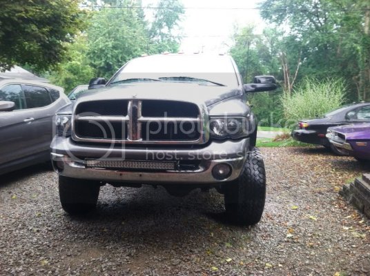

Had some time with the day off to make brackets and get it installed. I made brackets from 1/8" steel similar to CJC offloads design so she could keep her tow hooks, I would just buy theres if I did it again. I painted the brackets pink true fire like here underhood but there isn't enough surface area to really tell what it is
And pictures

Can't move it in anymore or put it behind the grille
The bar is 32" to the outside of the mounts an there is only 31" between the tow hooks
This is all the room there is between the bar and tie hook
All the room where guys usually mount lights behind the grille is taken up by the intercooler
