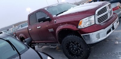

I just threw 35x12.50 kenda mud tires on my 2018 and it has been literally unstoppable in the mud, so long as there's clearance to keep going. Also did great in winter conditions. My only complaint has been a vibration around 60-70 mph, but supposedly that's due to a bent OEM wheel. We'll see once I replace it. I do a lot of road driving as well and don't mind the noise.
