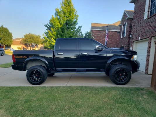

Hi guys just put a rough country 6" lift on my 2012 1500 crew truck. I have 35x12.5x20 on -44 offset rims. I am wondering if anyone is run 37's on this exact setup and if there are clearance issues. Right now I have about an inch of clearance at full turn. 369c3ddebd2a3f09a90c5526a0efc823.jpg

You'll need to cut the front plastic bumper to fit 37's
This was before trimming for 37's.
I had 35x12.5r20 but my wheels are 20x10 -24mm offset.

Thanks. What about the rear of the front wheel well? Will my -44 the rear has less room that the front.

The rear cleared without having to modify anything. You might have to grind in the pinch weld though. I'll have to snap a couple pics to show how close it gets.

Cool thanks. Already ground the pinch weld down when I first got the rims before the lift so I'm good there. Thanks for your help man. Going to go with the 37's as soon as my 35's are worn out. And my wife forgets about the 5k I just spent on the lift, rims and other things lol.
