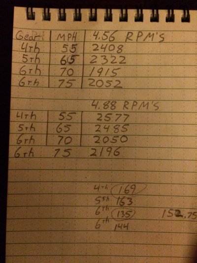

I like making comparison charts. Top is 4.56’s, bottom is 4.88’s. Both show the RPM’s in the same gears at the same MPH. RPMs are with 35” tires.
Very bottom shows the differences in RPM’s between the 2 setups. 152RPM is the average difference. High being 169 and low being 135.
Excuse my poor writing, and those are just the MPH I decided to compare. You can ise the calculator i linked to do it yourself.
And i got to say, 152 RPM’s may seem negligible but IMO and experience that small amount can absolutely change the drivability, depending on what your goal is. And if you just do the RPM difference for the 10MPH jumps than the average is 158.6

My RPMs are the same as your 35 w/ 4.88 and I think it's perfect.
