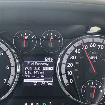

Also this has been my gas mileage since getting it done. Before hand I was getting 12-13 around town with similar driving. I have more than 30 miles on it so ignore the trip meter.
