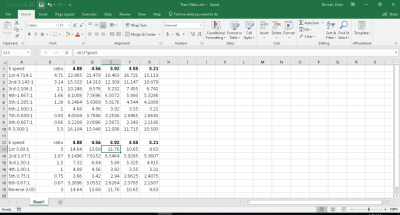

Any specific reason why 4.56 for the 8 speed ?
Effective gearing, but the 8 speed is so impressive in that regard that even with 3.21's in the 8 speed you'll have more more leverage with that than the 6 speed with 4.88's :), see calculation below, that's simply trans ratio X final drive
What trans do you have?
It would have to be the ZF 8HP ....

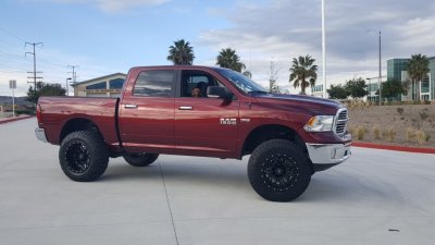

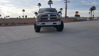

Love how your truck looks. Do you have a body lift on top of the 6in lift? Looks so tall. As for gears I cant compare the 4th gen gearing. My 2nd gen has 4.56 and I loved the change it made to the truck. My current truck has 3.21 and I kick my self for not holding out for a 3.92 cause I really dont wanna pay 2k+ for a gear change again lol. Is your truck delmonico red?
No body lift, just the 7" Maxtrac ... and yes it is Delmonico Red
Here are more pictures of it ...

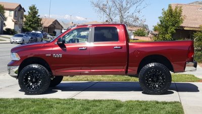

How do you keep her so clean lol and love how the sun can make it look like so many different colors. Mine is same colorView attachment 158430
I pressure wash her at least 2 times a week lol .. I only dry it with a waffle towel with some drying agent and throw some Meguiars ultimate paste wax ... Yeah .. sometimes in parking lots it looks a purplelish color and in the sun it looks very dark depending on the angle .. pretty bad ass color ...
