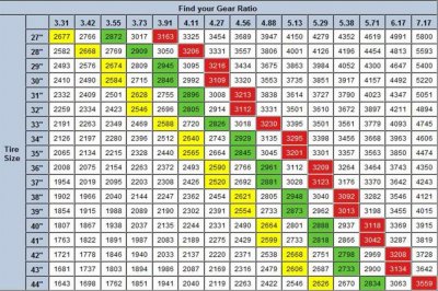

4.88 if you have the 5 speed, 4.56 if you have the 8
5/6 speeds have SAME overdrive ratio as the 8-speed. So trying to maintain 70mph if you live in a hilly area on the interstate all depends on tire size.
Always refer to a gear ratio chart.

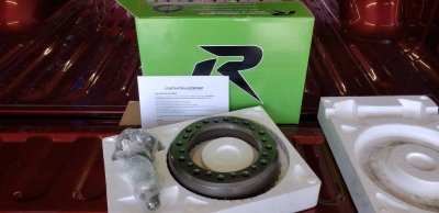

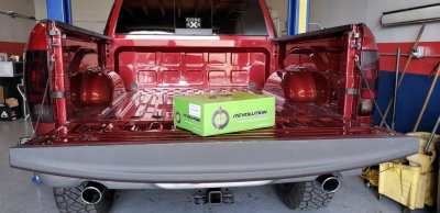

Just dropped my truck off to finally get regeared with Revolution 4.88s ....can't wait to get her back!
