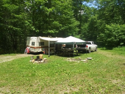

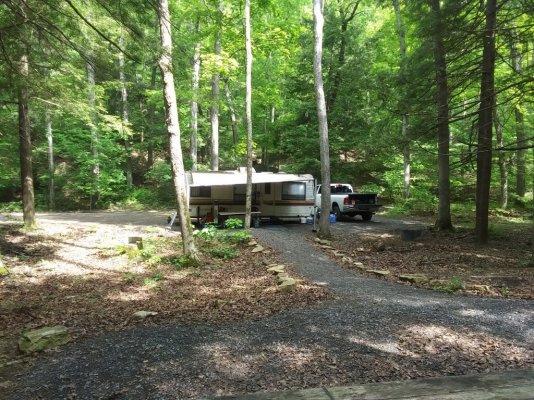

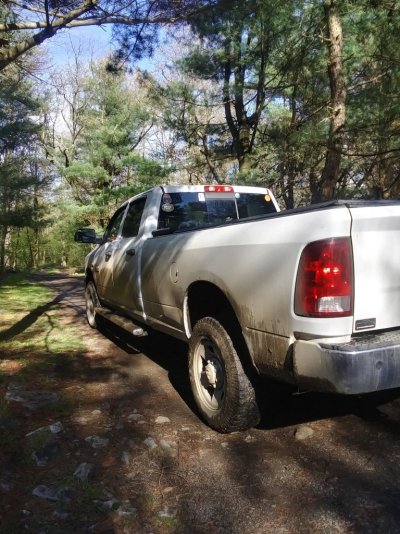

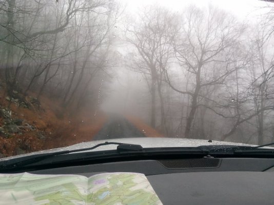

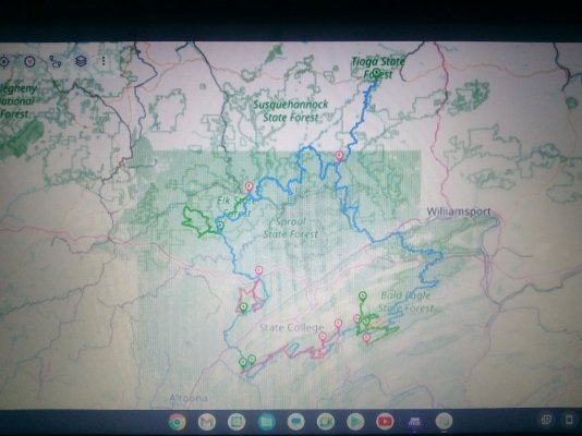

We overland with a long bed and a camper.

This is awesome. Your rig must be hard on smaller trails. Since my truck is not a full cab like yours it seems that one would be a little harder to go across certain trails. but I wouldn't think so since my works well off road. 2wd in this truck is amazing I haven't gotten stuck yet. "Cross fingers"

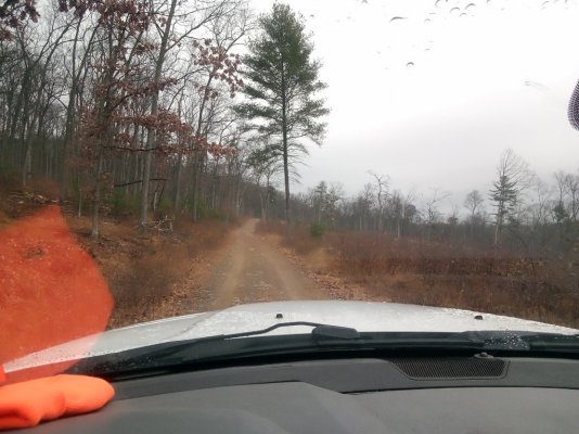

I live in Pennsylvania. I go all over the state to the forests. We camp every weekend from April to October, and once a month November to March.
I have not found a trail yet I could not go down. Pinstripes are a given here. My truck has many battle scars. It enjoys it as much as we do.
Most of the trails are like these. So no big deal...even the camper likes to go down them.
