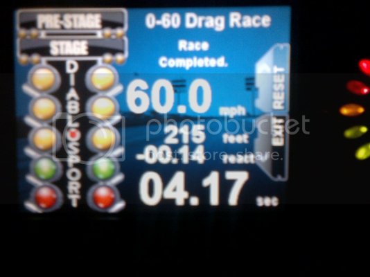

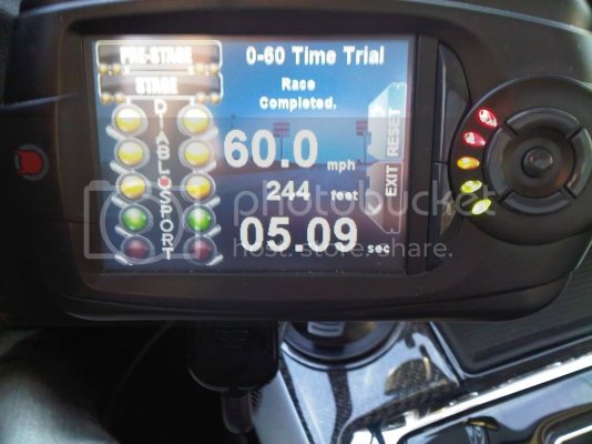

For seat in the pants "bang for the buck" launch difference
My TC swap did a much better job getting off the line for just $500
than any gear swap...and was easy enough to DIY install in my driveway.
I'd love to have 4.56's
but I'm doing okay without them too,
0-60 is 5 seconds flat Rolling on 20's and 305/50R20 Grapplers.
With the blower it's about as quick as Ram can get, even with 3.55's, heavy ass AT tires.
If you can do gears for under $2k with a decent LSD, go for it! (I would too)
But if you really want to blast off the line, a 2800-3000 stall TC Kicks ass for less than 1/4 of the price.
If you're not pleased after that, you can always add a gear swap later.

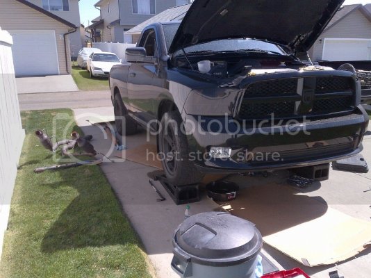

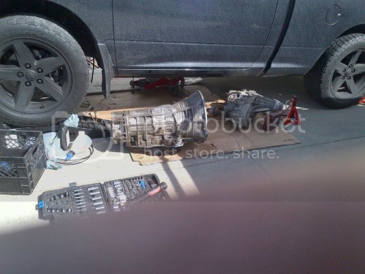

You have to drop the trans to swap the TC,
it's not hard, but takes a long time on a driveway without a lift or trans jack
...about 6 hours on a 4x4 Ram. (two guys casual rate of speed, basic hand tools)
Both Drive shafts, Transfer case, exhaust from the manifolds to muffler, 4-O2 sensors,
trans cooler lines and linkages, speed/pressure sensors, crossmember and starter all come off (3 hours aprox.)
Trans DipStick tube, Dust Cover to access TC bolts at fly wheel, need to crank engine over by hand
to rotate access to all 4 TC bolts by putting a breaker bar on the front of the crank pulley. Cake!
Top up new TC with fluid, Swap TC's and reverse install.
Need to rotate new TC onto pump shaft and wiggle until it clicks in twice to fully seat
making sure you reach both splined cogs inside the TC.

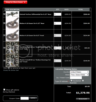

anyone have a link to the parts for a gear switch? I wanna take a look at the parts and prices involved but dont know everything that will be needed on a 4x4
BlackRamHemi
Aug 14, 2013
1,266
558
Edmonton Alberta Canada
2010
You'll need:
Ring & Pinion Front 8" Front
Ring & Pinion 9.25" Rear
Detroit TruTrac or Auburn Limited Slip Diff (rear only)
Master Install Kit 9.25" Rear
Master Install Kit 8.0" Front
Should run around $1400
Matt stocks all the above:
Moe's Performance
Install quotes will vary from shop to shop,
Fluids, Shop Supplies, Labor will run you another $1k , but could be as high as $1500 ($750 per end here)
But some shops wont warranty the gears unless they supply and install
...and their prices will likely be higher than Matt's
