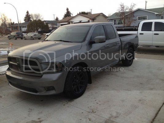

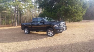

Alright guys here's the deal. Just recently bought a 2014 ram quad cab 4x4. I put a 2.5 leveling lot on but I just miss the drop I had on my 12 express. I am refusing to pay almost $900 for the ground force kit. That's just outrageous. Especially when I only paid 300 for a beltech 2\4 . so my question is what 2wd kits will work. I've searched the forum a lot but haven't got a real deffinate answer. I know the spring are diff because 4wd is coilover etc etc. Here's a pic of my old ram and new ram. Loving the new truck with the 8speed and 3:92s. My plan is to lower on the same SRT wheels.

I can't help you with your question but the silver truck looks great!

dude can we get more pics of your old truck and info haha thing looks so dope

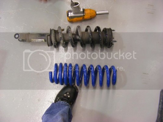

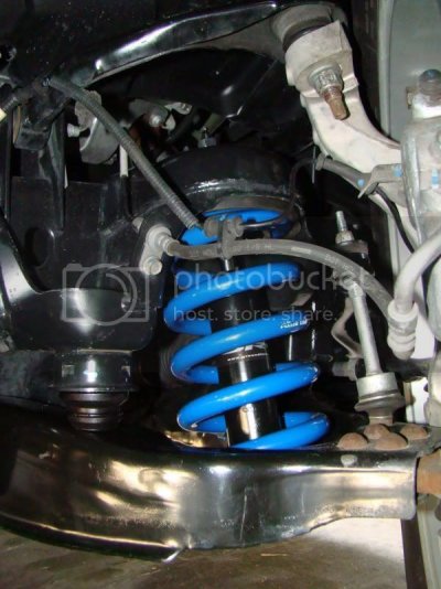

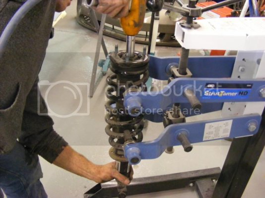

Ground Force kits for 4x4's re-use stock struts with new progressive rate coils
that need to be swapped over with a Strut Tamer...
The Front on a 2WD is just a non progressive coil with an independently mounted shock within the coil.

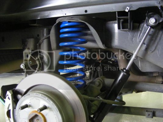

Rear progressive coils vs stock
mounted on my 4x4

Thanks guys. I knew the front springs would be different but I've seen a few threads with guys using the 2/4 drop with front spindle and said it worked fine without cv problems. I'll just get 2/3 and be done. Just sucks. And for my old truck. It was just a 2012 express belltech 2/4 drop on srt wheels. Had a vararam, muffler delete ran 14.2 with those mods and 13.3 with a 75 on stock tune hitting the limiter (This was before tuning was available )
