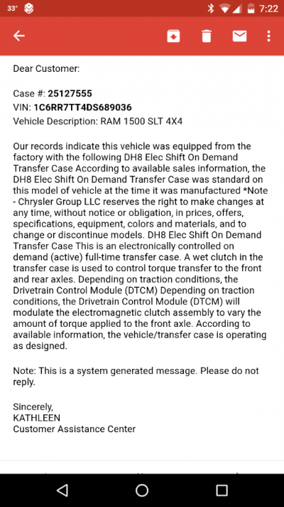

There is no published information, I've said that repeatedly. What I was talking about was the conversation I had over the phone with a man named Don Hughes who was the engineer I had spoken to on 8/14/2014. I can show emails back and forth between me and 3 high ups in Ram talking about this whole thing, and the information was posted here around that time, so if you want that information you can contact ram and speak to him, or just speak to ram customer care, they said the same thing.
You didn't answer my question. Above the old system that 4 auto, above the GM system with 4 auto, provide one advantage over those systems, the advantages of a system adding 4 auto are numerous, the advantages of this particular transfer case over those transfer cases don't exist.
Here is the email that I got from a case manager that halfway explains it.f134ad66b57987ad12c83cd7ffeec3a8.png
