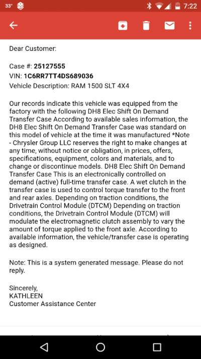

Here is the email that I got from a case manager that halfway explains it.f134ad66b57987ad12c83cd7ffeec3a8.png

Your email shows us what we already knew... torque is pushed to the front wheels of the ram based on need. Which is why some people can get spinning front tires at a stop and some can't. Putting it in 4lock on a slippery surface, letting it idle, will spin front, and back. What you've shown us is nothing short of Ram telling us how amazingly advanced the system is ( thanks ram ).
