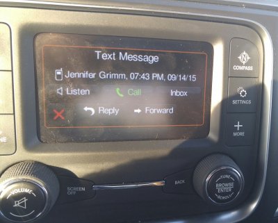

Just to confirm, text messaging works both ways ( incoming read out and pre-defined replies) on my RA2 5.0 with latest firmware v 5.2.20.1 and my LG G4 with lollipop 5.1.1.
I never noticed that there were pre-defined reply texts you could send, thought that was an 8.4 RA4 feature but it works. Go figure.
