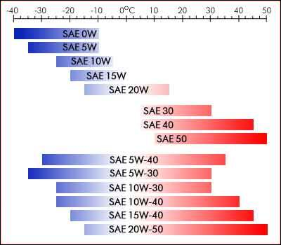

5w30 would be good, I'm actually running 10w30 in Ca next change. I will let you know how it goes as I also am keeping the tick away with redline. Currently 5w30 in my ram, and yes you can easily use 5w30 with those temps. I would start a little concern at -10, maybe then I would start thinking about zero winter rating because if it can go -10 it can go lower. At -20 I want zero winter rating. see visc chart, I like to be above this a bit, but you could even get away with 10w30.
Did you read the oil filter thread? good info there as well
