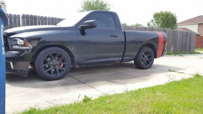

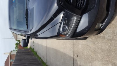

do you have any pics to show how much the front wheel sticks out?
C
CzBlkExp
Sep 20, 2015
31
11
The tire stickout is actually less noticable than it was with just the spindles. I would say its probably about where it was stock.

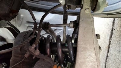

can you snap some sots of how the front A-arms sit. Also what bump stops are you using or are they still stock?
I am thinking of installing a mixed kit like you did but with a 1" Crown spring up front to get the a-arms closer to stock position but retain the 3"+ drop I have already

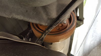

check the heat shield next to the driveshaft around the gas tank. Mine was touching after lowering it.
Stock bump stops at the moment, I have the belltech bump stops but they aren't installed. These pics are with the rear end up on ramps so it's a little more compressed than normal ride height.
Thank you sir, that was the problem. I didn't grab a pic before but with the rear on ramps there was ~1/4 of clearance around the ring on the drive shaft. I guess with full weight and a little speed it was rubbing. I could see a little shine on the drive shaft ring where it was rubbing. I clearanced it a little with a pry bar and went for a test drive around the block.
Thanks for this pics. I thought they would stick out more. Nice looking truck BTW.

more pics
Original pics at the start of thread are with 4 inch drop coils in the back, these are after cutting 2 full coils off the McG 4 inch coils to give ~5 inch of drop. Currently 31 1/4 inches to wheel arch in the front and 33 1/4 inches in the back (with my tire/wheel combo). Still has ~6inches of minimum ground clearance at the lowest point on the body which is the transmission cross-member. 2 pics with the silver VW are the after cutting rear coil pics.
I will say towing or any substantial load is probably out of the question without air bags. About to go get it aligned now so I'll update if any issues pop up.
glad it worked out for you, that is a disturbing noise on a first test drive.
