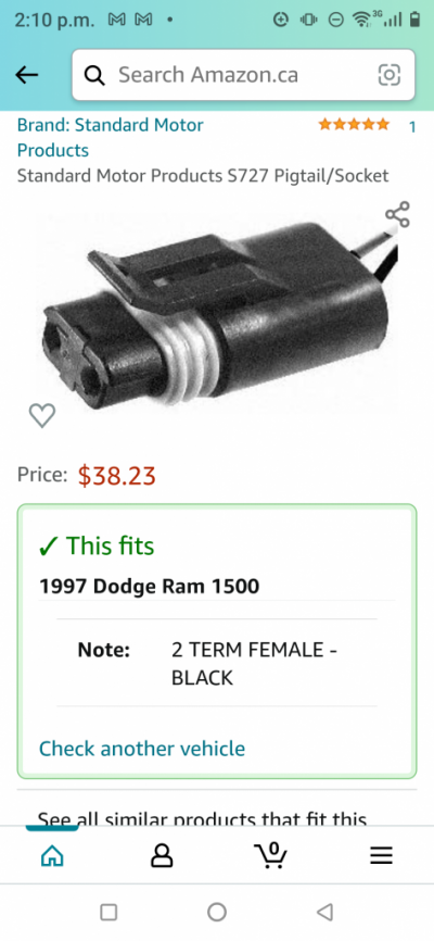

Broken primary wire(s) to ignition coil, the fan causes varied air movement, vibrating the wires which in turn breaks the copper in wire

ramtruckdriver
Nov 26, 2012
18
Sudbury Ontario
Dean, he is in contact, as recently as 40 minutes ago, through IM. Keeps the thread from filling with quotes, I couldn't post a picture in IM, so I went through the thread instead
