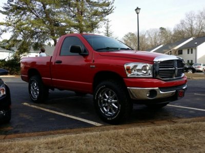

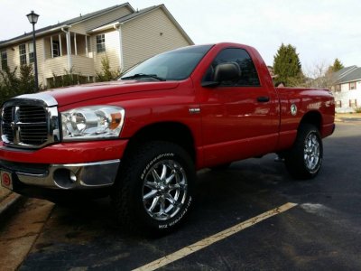

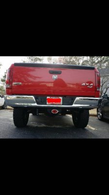

Not that bad actually. The rears were done in 20 minutes. The fronts took me about a hour and a half. Luckily I work at a dealership and have access to a lift, spring compressor and air tools.
RAMHEMI06
RAMHEMI06
Aug 31, 2013
40
15
Georgia
2006
HEMI-5.7
I had some 2" aluminum spacers there before. After removal the 285/65R20 BFGoodrich All Terrains do not scrub anymore. The 8 year old struts must have been a little tired haha.
No problems with the lower strut mount bushing?

Thanks! Not at all. The only issue I had was getting the spring seats off of the factory strut but a lick with a air hammer made it easy

Looks good, and much better option than the spacer. I am sure you feel the improved ride!

Absolutely! It looks and rides a whole lot better.
