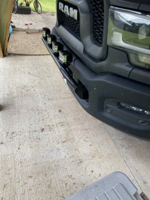

@Trailmaker i think has the Randy Ellis bar. But he also has some ditch lights by the A pillars. i think they are like 3" Cubes

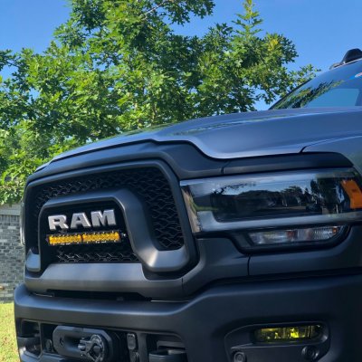

I added a Baja Designs S8 light bar to my grill without making any mods to the grill. I’ve tweaked the position slightly for aiming of the light since this pic but it’s still mounted the same.
I also have Baja Designs XL’s on the A pillars

That looks great! Can I ask how you attached the light bar to the grill?

I added a Baja Designs S8 light bar to my grill without any making any permanent mods to the grill. I’ve tweaked the position slightly for aiming of the light since this pic but it’s still mounted the same.

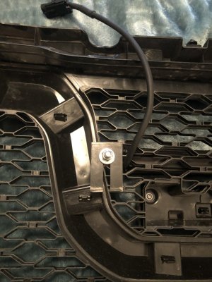

I used the the L brackets that came with the light bar and then made a 2 little backing plates from some flat slotted steel I had laying around.
In the picture with the hardware the 2 brackets at the far right came with the light bar. The 2 flat c shaped parts are the backing plates I made. And I used a couple 2 1/2 or 3 inch 3/8 bolts and washers to sandwich it all together.
Also a pic with the backing plates on the backside of the grill. This was test fitting a I turned the plates horizontal because it looked better. (Even though no one will ever see them lol)
It sounds harder than it actually was and you could find several different ways to do a DIY grill mount this is just what I came up with. And it’s worked great so far.

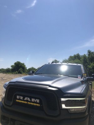

Here is what I did. Inspired by @Scotts26 just a slightly different approach.
I used the SDHQ A Pillar brackets which I like because they are compatible with the AEV Snorkel and ended up making my own bracket for the S8 so that it would distribute the load evenly and handle rough roads. I use a Bantam SPod mounted to the fuse block.
Really happy with the way it came out.

@HeliNomad Looks great man! I considered making a full length backing plate for added strength but my 2 smaller ones have held up well with no loosening after a few thousand miles and a couple trips off road.
That’s great! The grill complex is really well designed on these trucks. Really i just needed an excuse to try out my new Miller welder. [emoji6][emoji851][emoji39]
