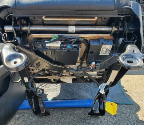

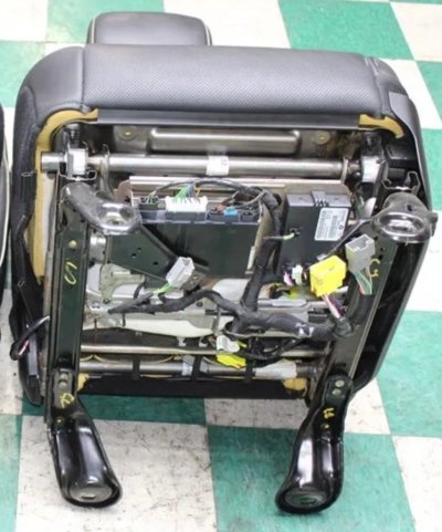

I know a lot of this has been discussed already but from my understanding I have a 2015 mega cab. I should be looking for a 2019 to 2020 Mega cabs 5th gen seats. I was told that it is plug it and play but judging from the pictures the plugs don't fit. Does this make any sense?1000002969.jpg1000002970.jpg

I know a lot of this has been discussed already but from my understanding I have a 2015 mega cab. I should be looking for a 2019 to 2020 Mega cabs 5th gen seats. I was told that it is plug it and play but judging from the pictures the plugs don't fit. Does this make any sense?View attachment 538141View attachment 538142

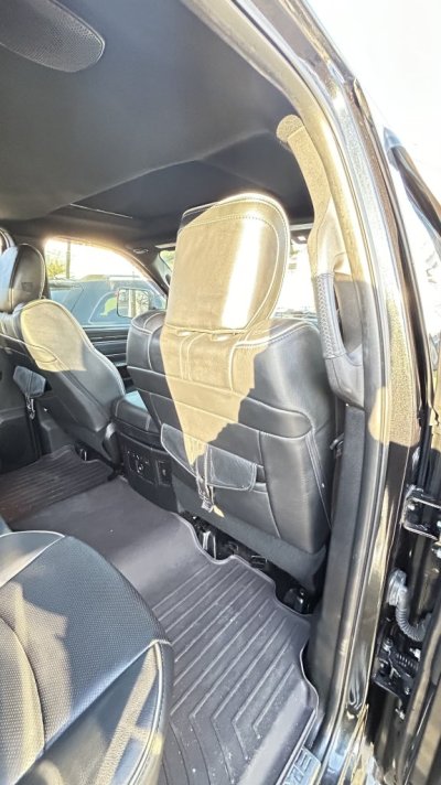

It won’t fit, completely different harnesses, but the only difference between the 4th Gen HD seats and the 5th Gen HD seats is the front head restraints and the upholstery, I’m also currently swapping out the head restraints and putting in ones from a 2020 Ram 2500 and they fit perfect, plus it even almost looks like a 5th Gen HD seat!

Thank you for the reply. So basically you're saying the seats have not changed except for the wiring. So there's no difference in Comfort between a fifth gen and a 4th gen
Basically yeah, exact same thing, so I would say just swap out the fromt head restraints and put in ones from a 5th Gen HD.
