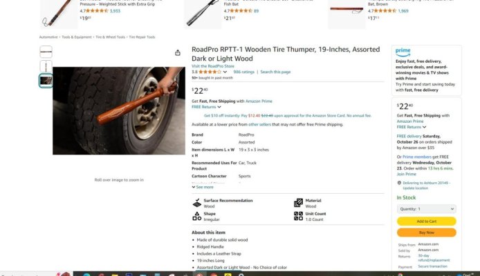

What's all this talk about tire pressure monitoring systems, anyway? Whatever happened to the Macho man kicking his tires, grunting like Tim, the Tool Man, Taylor, and getting into his truck and driving off?? LOL ;)
GOTTA have yer "Thumper" !!!
