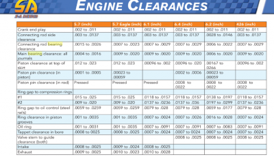

The assumption is that a 5.7 in a 1500 is built to the same specifications as those found in a 2500/3500. Anyone familiar with Mopars knows that there has always been technical differences in their motors based on service (EX: 360s came as 360-1 car, 360-2 truck, 360-3 HD, 360-4 police).
Look at the eight digit in the VIN. The current 5.7 engine code is different for the 1500 and HD motors, as well as cars.
In a completely healthy engine, increasing the viscosity of the oil could produce oil flow issues (viscosity=resistance to flow). This is important because when they went to MDS they changed the main bearing clearance from .0034 to .0021.

Damn good to read something from someone who knows what the hell he is talking about. Rather than some of these egg heads pushing their home grown BS. 56W-20, period and only should be sued.
Here is an early GM 2000 series 5.7 pdf......clearances on crank are tight......no 5w-20 recommenced back then......LoL
Should also be comparing 5.7 to 5.7 as in 1500 & 2500 not the 6.4 in the 2500
https://www.skidim.com/images/L510015.pdf
