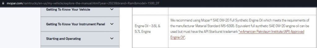

Part 2
0w 20 or 5w 20 or 5w 30
So Mopar.com Ram 1500 Classic 3.6 vs what dealer sent to me at purchase (PDF of manual)
Two sources for same truck config with 2 different reco's and one with an option...
clear as mud but for a June/2023 built 1500 Classic with 3.6 5w 30 is OK.
What say you?
