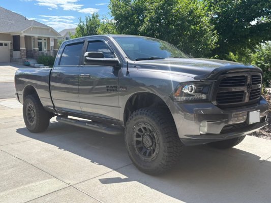

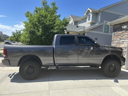

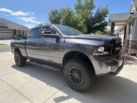

I have a 2016 1500 Ram Sport. The factory specs say it’s 78.5”. I had a 6” lift and 37” tires put on. Yet the measurements are
80.5”- should it have risen by roughly 9.5”?
What am I missing?

Okay here is what I have…ASSUMING my measuring point is center of front fender is correct.
Ground to fender: 44.25 inches
Center of Hub to Fender: 28.25 inches

My stock ‘17 big horn has a measurement of 20.5” from the center of hub to the wheel opening at the front. Looks like you got more than a 6” lift…unless your measurement was at the back?
The ground to fender opening is 35.5-36”, so looks like you gained roughly 8+” of total height with the tires too.
