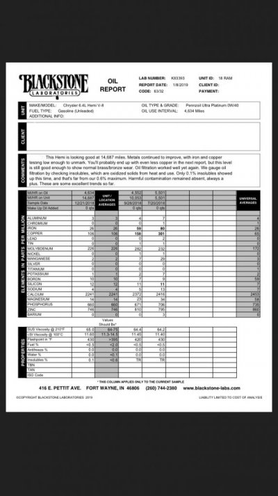

Here is another, a bunch of different 0w40's even the mighty redline, which might be worse then all of them. Even a 5w40 tossed in. Interesting you see the 5w40 only buys you about .5 visc in shear, still too much swing between winter rating and weight. When looking for 0w40's best pratise if find one with Porsche and Mercedes specs, just maybe they add enough pao to keep it in grade. Every oil in this uoa is now a 30 weight.
well BITOG dont want to share uoa's, here the thread note the uoa. Mind you thins is a Nissan, your hemi's are most likely gonna shred viscosity a lot more imo.
oil-jpg.84382

I posted 9 uoa's all under 8k miles, everyone of them, look at cSt visc, second line on bottom section. The point is using 5w30 in 0w40's stead is scientifically sound, hemimann is correct. It also correct to run what the manu says, just know if you do run what the book says your engine will in fact have more carbon building molecules that will create more contamination in your truck then if you ran a stout 30 weight. If you think 0w40 stays 0w40 that is completely incorrect, it does not, as noted in 9 uoa's many different oils.

There ya go, your fallacy is thinking 30 weight goes to 20 weight, look at blackstone thread. It doesnt shear near as much because it has less vii's. My 3 uoa's on 30 weight all are thicker then the 9 uoa's I posted. Good day, glad I could enlighten you to hemimanns point. No real reason to continue, the facts are what they are. Something like PUP 0w40 is likely a twenty weight oil but full of vii's. 30 weight oil is gonna likely be thirty weight oil or close with a few vii's. First page in blackstone thread proves the point, look at the uoa's, 30 weight near viscosity 12 after 10k miles. So I'm sure now you at least understand, what you do with this info is on you. Peace
