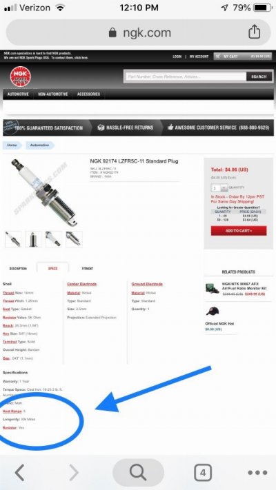

The plugs in the Hemi is actually a 30,000 mile plug. I have all data for my 6.4 and its an NGK part number for the plug. If you search the plug on NGK’s website it says 30,000 miles.
Dont believe everything your manual tells you.

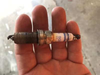

I did mine at 100k and it wasn’t any big deal at all! Put factory 100k plugs back in
Wait a second
Your factory installed plug was a Bosch...?
Im done guessing what is in everyones truck
That is even more reason to check them at 30,000 in my opinion. You dont know what is on your truck.
By book says 100,000. My part number in my book AND on alldata is an NGK plug number. And NGK says my plug is 30,000
So im checking at 30,000

digging up an old thread here but where did you get that ngk part number? per NGK, the correct replacement plug for the 6.4 is 96779, which they show has a 100k service interval.
