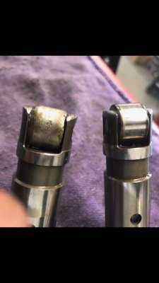

Its a commercial truck so no warranty, the issue they say is that roller lifters lock up and create the damage . I had to use all factory parts except for the lifters . I found them in Melling so Im hoping that should give me longer life now. parts cost me 1500.00 plus another 1000.00 In labor . It will start with a check engine light and a code for misfire on a certain cylinder . We tried plugs , coil packs , even looked at the springs but it was a lifter.

Id advice you to use good oil and change it regularly. I was also told the Hemi in tow trucks is not a good design . So if you use yours normally I do not see what you should have the same issues as mine , Mine happened at 140,000 miles on one and 100,000 on the other . Also yours will be under warranty. I would not hesitate to buy another hemi for normal use .

Do you have a lot of idle hours on them? One theory out there is that since the cam is splash lubricated that idle doesn't provide enough oil due to lower oil pressure and that there is a " bleed through" path for oil to go thru the lifter to the roller and therefore the cam. High rpms tends to lube better.

Being a tow truck , Id have to say yes it has higher idle time than most normally used trucks. I have thought about that as well . Im just surprised Dodge has not admitted to an issue even after I bought 1500.00 worth of parts from them .............. twice

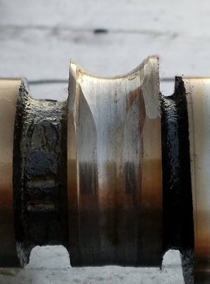

S.O. a ***** !!! That probably the worst I've seen .
What oil do you use and what's a typical OCI ?
Oops just seen you answered that. Mobil 1 and 5k oci ...

That black carbonized oil between the cam lobes [emoji848][emoji848] looks like a higher thermal compatible oil may suit you better with your particular use of your truck with high idle times at high temps especially with a splash lubed camshaft .
Hope this helps !
