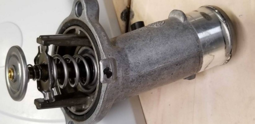

Aight, a picture of my t_stat and housing, 2016 6.4L 2500 PW
If we can find a manufacture who produces the two spring actuator setup, even if it were a different application but was a two spring set up at 180F, then I think maybe we could just swap the springs. The unit does come apart right at the blue pointer, in second picture.
I'm cyber shopping for a similar configuration thermostat, when I find one online I am going to call local parts store and see If one is in stock, maybe I can try a spring swap today.
There are several OE replacements on Ebay, all sold as one piece, used and new. Their price listed iswell below the cost I was quoted locally.
I ok with someone telling me I'm wrong and sending us an easier solution. The links that are posted in this thread are much appreciated but I don't think either will work. I'm going off the fact that there looks to be only one spring on either unit. 3dff747b2912bda33ce3c8e71591a818.jpg

I don't see any way a regular thermostat will fit . I wonder if it could be machined to take one for a 5 7. Such a simple thing and FCA had to go in complicated .

That thermostat looks beefier than whats in the 1500's and cars. If you can remove and replace the springs, you may want to see if you can find specs on the springs for your stock one, the stock 1500, and a 180 thermo for the 1500. If you can't find specs, you could always take them yourself, which would be more complicated obviously. There are websites where you can have custom springs made to your specs. Years ago, I bought springs to upgrade a Nerf gun. It would leave welts. :D

Have you checked to see if you could swap the 1500's thermostat housing on.The bolt spread looks close,and you might be able to just swap the housings.
Nope, I sure haven't. A few other bolt patterns match, if the stat housing matched, that would be bada$$.
I'm headed in to see if I can get some springs or a couple full t_stats that I can scavenge a spring from. The first thing I will do is check the 1500 bolt pattern. Thank You

I looked into this in years past and dropped the idea. The SRT guys who did it had problems causing the fuel to run rich and throw codes. Seems there is a narrow window by design above 180 degrees these engines are expected to operate at and the old school trick of throwing in a cooler thermostat alone without tuning is a money wasted.

I run a 180 T-stat in my wifes bone stock untuned 2016 R/T Challenger with no issues. My buddy runs a 170 in his 6.4 untuned Scatpack with no issues. They go into closed loop mode at 160F,a 180 T-stat is well past that point. That's a myth that originated a few years ago,and now there's guys who've never tried a 180 T-stat in an untuned truck,but sure believe in the myth,and it's made them scared to try a 180 T-stat,lol
